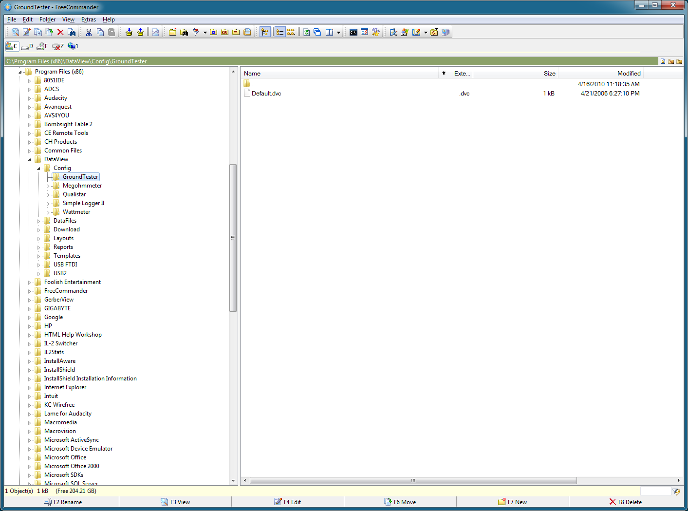

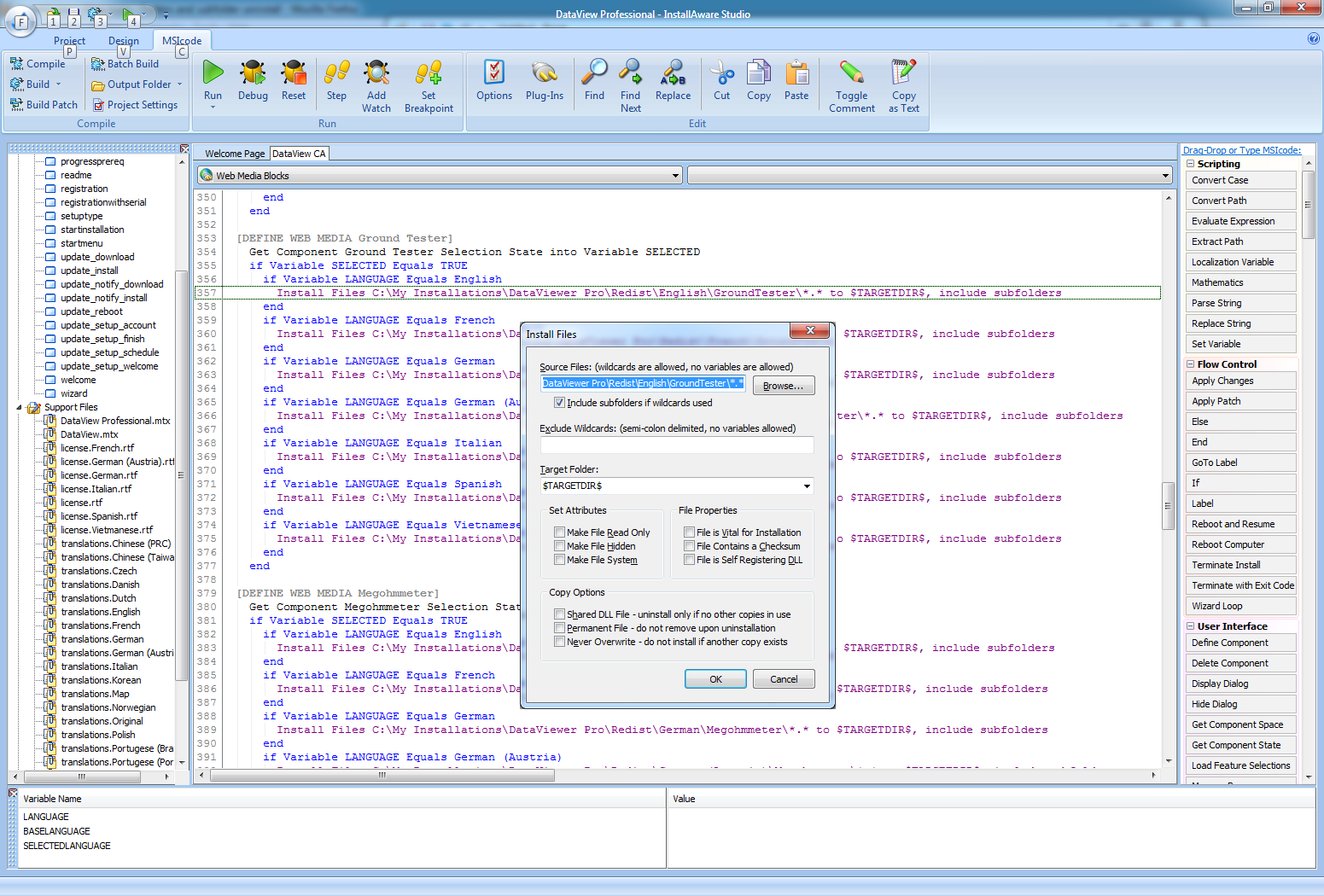

Attached are the images. Note that my setup has components that merge folders with one another. For example in the screen capture you can see the following folders in "C:\Program Files (x86)\DataView\Config"
GroundTester
Megohmmeter
Qualistar
Simple Logger II
Wattmeter
Each of this is from a different component.

I got it to remove the install folder (and subfolders) by adding
Recursively Delete Files $TARGETDIR$\*.*
command before the Apply Uninstall operation.
