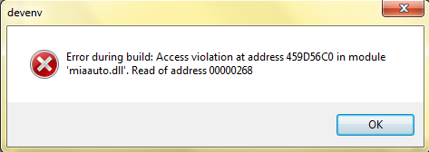

I just recently installed InstallAware 9 trial version on my Windows 7 64bit system. I am seeing the same error when I am just trying to debug my program. What is the cause for this?
I don't need to build the Setup at the moment, can I just disable InstallAware in VS 2008 for now?
Many thanks!
- AccessViolation.png (22.06 KiB) Viewed 21796 times

We have just published InstallAware 9 R2 version 9.09 on our main website. Please install this latest version. This latest version fixes some sporadic Visual Studio issues for all versions (2003, 2005, 2008, and 2010).
