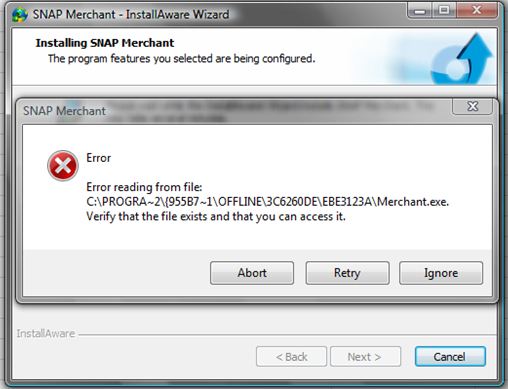

I have an installer that we are using on our machines internally and externally running Windows XP Home, Windows XP Pro and Windows 7 64-bit. They all work fine, but I have a remote employee who runs Vista 32-bit (ugh!) and for him, the installer always fails. I have attached a screen shot.
Any idea what could be causing this? Could this be some whacky UAC thing on Vista? I don't have these problems on Windows 7, and our program does not require any special admin rights at all so it can install and run as a normal user.

- Screen shot of the crash
- IA_Crash.jpg (41.12 KiB) Viewed 9600 times

I am unable to get into the users machine. I guess 'Remote Assistance' does not work so flash! Grrr.
Anyway, the install script is pretty simple, so I am happy to post it here. Just a basic .Net install. The only thing I did above and beyond a simple setup is to add my own dependency on the 'Slim DX' runtime which we are using for our audio support (long story). But the install already got past installing that dependency correctly as it failed installing the main executable program.

One thing that comes to mind without considering UAC is the possibility that this user is running AntiVirus that's deleting the file?

Re: InstallAware CRASH on Vista 32-bit?
I'm leaning toward AntiVirus involvement for now.
Can you try install again with AV turned off (if applicable)?
If you were to get another screenshot of the error, could you include the progess text as well, to see where the error is appearing?

I will have him run it in logging mode first with AV on, and then try it again with it off. He is running Trend Micro Anti-Virus.
