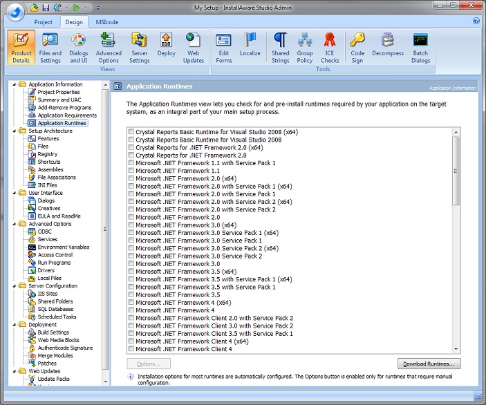

The Assemblies section is intended for registering .NET dlls to the GAC.
Does your application require Visual C++ runtimes? If that's the case, then you should make the appropriate selection in the Application Runtimes section:
