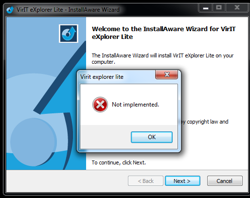

I really have no problems on building the project and installing it on every OS when i make a clean install.
The problem comes when I upgrade the same product (i.e. same product code but different revision code) on my Windows 7 Professional x64 (MSDN final, so no RC nor beta).
Everything goes fine until the reboot, when I enter Windows, the setup restarts in the RunOnce way (i.e. no desktop, no taskbar, etc) but after the language selection dialog, i got an error that says only "not implemented". However, after I click OK i can continue normally and complete the installation...
Any idea on how to fix it?

- Test.PNG (43.45 KiB) Viewed 4478 times
