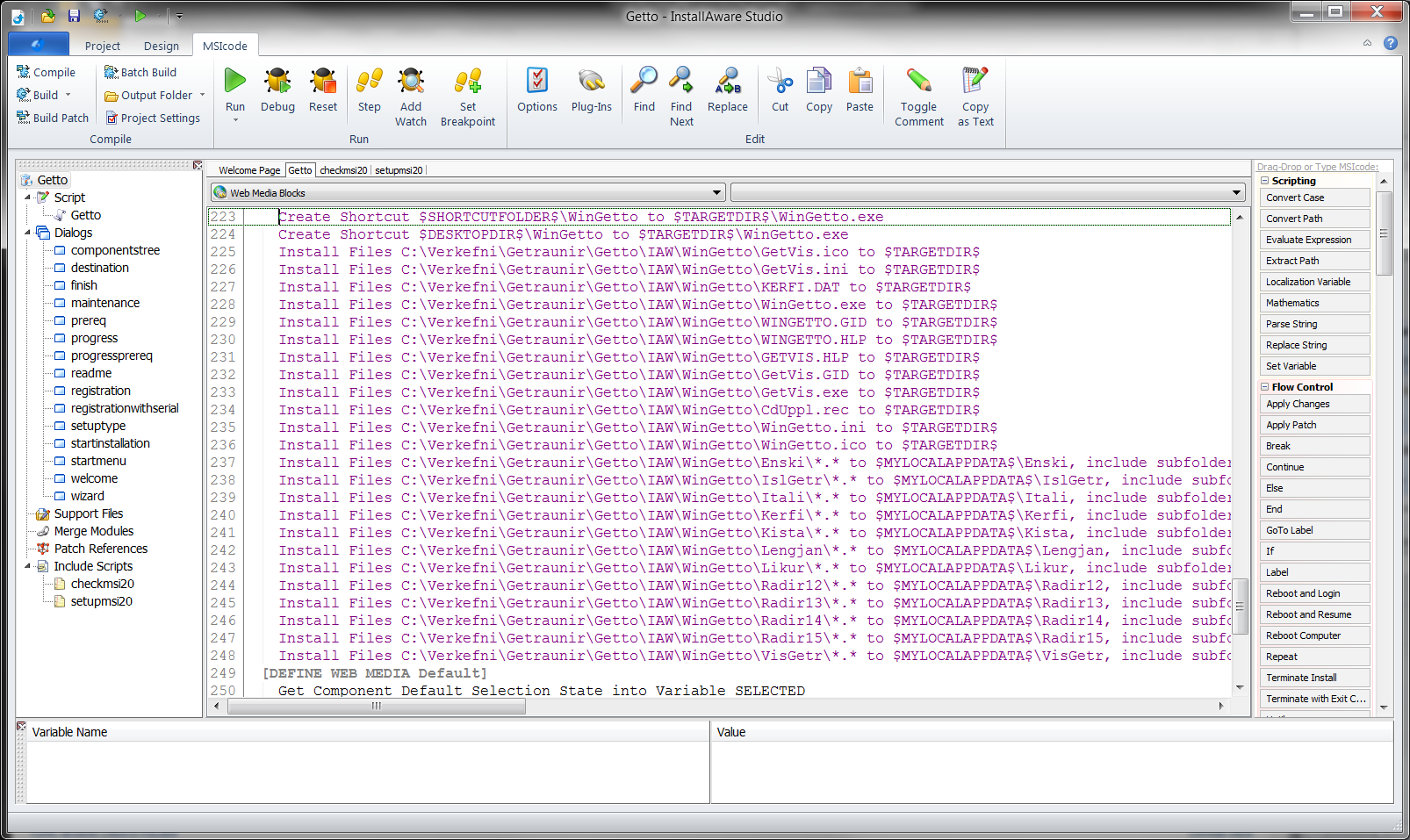

Could you please attach a screenshot of your main IA screen?
Re: Create folder
Don't know what you mean by main IA screen, or what possible difference that would make, here is one screen shot - .

- InstallAware.png (262.33 KiB) Viewed 7860 times
