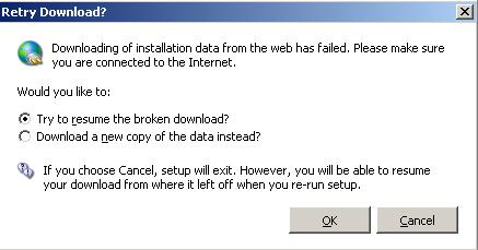

Ok, here is what i want to know.
When you launch the installer with the UI, if the web data is not available, the installer shows the dialog attached below.
So, how can i do to make my silent installer report the same error? Is there a way to have an exit code ?
Hope i was a little bit clearer than my previous post.
Best regards,
Best regards,
- RetryDownload.JPG (19.47 KiB) Viewed 6837 times

Usually setup bails out the moment an error like this occurs. It doesn’t matter whether the setup is silent or not - it will just bail out (the EXE should return an error code instead of success, of course).
However, if you set ABORTONERROR to FALSE, you can then read ABORTEDONERROR after web media block commands to see if all went well or not (TRUE means an issue occurred).
The help file pre-defined variables topic talks about these variables in detail and does provide usage examples.

Ok thank you for the hint, i'll read installaware help instructions to make it work.
