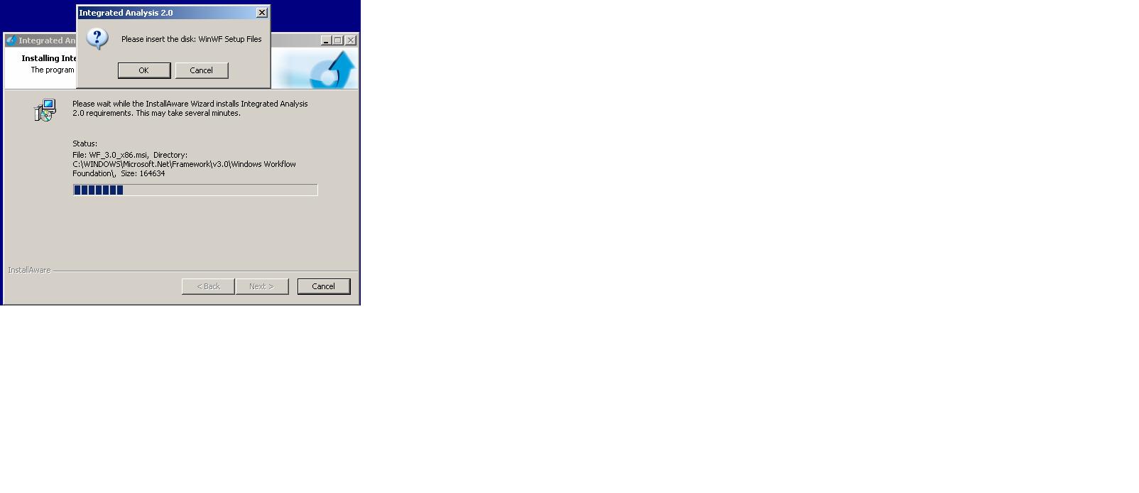

When I have the installation check for .Net and the machine doesn't have it. I get the Please Insert the Disk: WinWF setup files. Then the install fails as it cannot find the disk.
I built a cd build with all the files uncompressed. If the machine passes the .Net check then my program gets installed correctly.
I have attached a screen shot, how do I remedy this situation? I have the admin eval version of the version 7.

I've found the solution. I didn't cached the installation files on disk, so I've got the error. After I changed the setup to cache all installation files on disk (due to another problem), the installation goes through without an error.
It is a little bit strange, but it works now.
