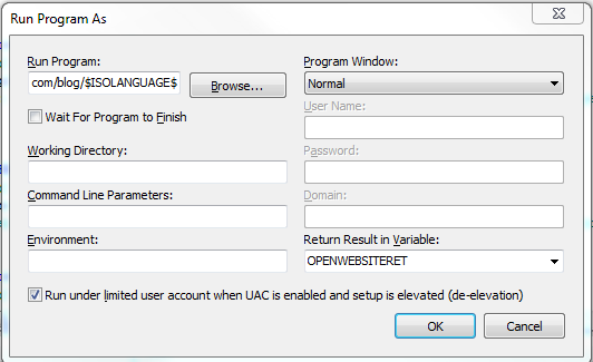

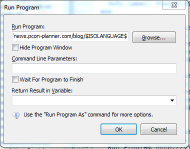

Is this still possible in IA 12?
I am only able to do this with "run program". With "run program as" I get error code "-11" back.
But I would prefer to use run program as because there it is possible to start the browser de-elevated.
Attached the script entries:
- Run program as
- runas.PNG (26.48 KiB) Viewed 8675 times
- Run program
- run.PNG (35.82 KiB) Viewed 8675 times

Re: open webpage
But I want to use the default browser, is there a way (without looking for it in the registry)? And why does it not work with "run program as" like it works wit "run program"?
Re: open webpage
This seems to be related to Windows - when I use runas /user:USERNAME http://www.installaware.com, I get:
RUNAS ERROR: Unable to run - http://www.installaware.com
2: The system cannot find the file specified.
