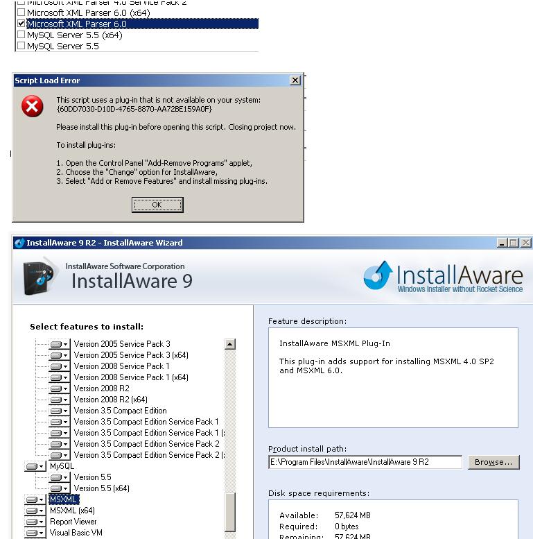

"Microsoft XML Parser 6.0" plug-in does not install when selecting features - running "InstallAware_9_With_Runtimes.exe"
If I check "Microsoft XML Parser 6.0" in Application Runtimes and try to build I get the following error:
This script uses a plug-in that is not availble on your system:
{60DD7030-D10D-4765-8870-AA72BE159A0F}
Please install this plug-in before opening this script. Closing project now.
The x64 version (msxml60bin_x64) does install though the x32 version does not. I need the 32 bit version.
"Microsoft XML Parser 6.0" x32 plug-in does not install
- Screen shots of problem
- MSXML Plug-in not installing.JPG (100.45 KiB) Viewed 5286 times

Re: "Microsoft XML Parser 6.0" x32 plug-in does not install
This is our bug, please accept our apologies
The fix along with a patch download is discussed here:
http://www.installaware.com/forum/viewt ... 3&start=60
(look at the last posts on the thread)
I tried that (before posting this issue) and I still got the error.
You may also need to manually update files copied to your project folder if the runtime was added to your project before applying the hotfix.
The latest update to InstallAware 9 R2 (9.08):
www.installaware.com/forum/viewtopic.php?f=2&t=5658
Contains an in-line fix for this issue.
