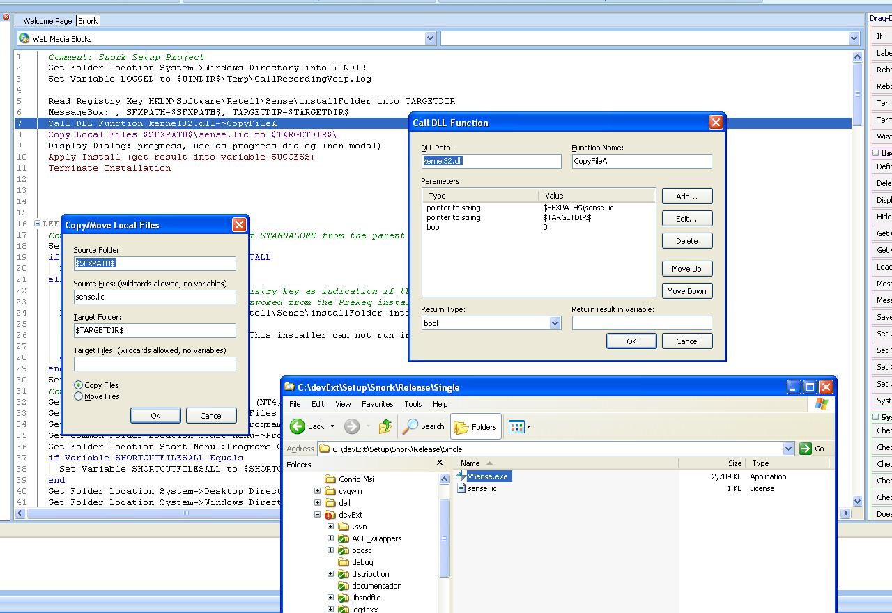

Using IA Studio 9 R2, in Single File installer mode on XP Pro SP2, I try copying local files from where my installer is located $SFXPATH$ to the installation folder $TARGETDIR$.
I have tried both "copy local files" and Use DLL with CopyFileA but none works. I read everything about it in the IA help file, I tried everything suggested in google about it and still nothing works.
I attach a JPG image with my script snippet, dialogs etc to show exactly how I am using it (although I have tried dozens of other variations, with and w/o double quotes for instance).
I have spent 5 hours already on what should have been a trivial operation.
Help, please !!!
Gary
IA 9 R2 will not copy local files.
- IACopy.JPG (197.99 KiB) Viewed 6243 times

In the sample project, there's a problem with the copy call - the second parameter does not provide the destination file name.
Also, again in the sample project, because you haven't called Apply Install, the Windows Installer action (in purple) will not have effect.

Finally, you are attempting to call kernel.dll instead of kernel32.dll
If you inspect the return value of the function, it says DLLLOADFAILED...
