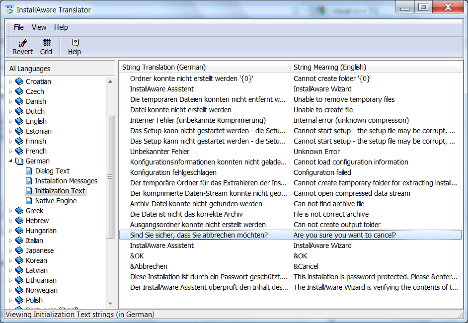

Are you able to edit by going to "Shared Strings" under the Design tab? Look under the Initialization Text.
It looks like it should read "Sind Sie sicher, dass Sie abbrechen möchten?" in German...

I already checked the shared strings before... they were all displayed correctly... :?
The problem obviously was related to our installation. After numerous tests (dialogues were displayed correctly when running a debug) we decided to reinstall IA from scratch on a clean system. I used the trial version on another computer with my project and found that it worked.
Now everything is working as expected and we are up and running!
