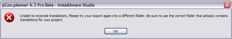

2. Another problem: I made an update of a product and deleted/added some dialogs and changed setup script. I now followed the manual and tried to localize again (the new literals). But when I select the old localization export folder I get this error (see attached picture). What did I wrong, what can I do to prevent this error. Do I have to localize completely new now?
Error Message
Error Message

As for your second questions, could you attach you error message again? I cannot seem to access it.

Agian my error message attached:

I am not able to reproduce this issue here. What changes did you make to your export folder? Could you perhaps create a reproducing example project?
Thanks!

I deleted all update dialogs and few more from project and added som new ones for the next version. I will try to reproduce it here step by step and then tell you? Can IA dev team tell you when this message will occur?

Please let me know if you were successful at reproducing this.
