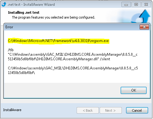

One of the server recently (after upgrading from 10.0 to 10.10) began to produce Installers where the RegAsm command is called from .NETV4 (C:\Windows\Microsoft.NET\Framework\v4.0.30319) even if the destination machine does not have .NET 4 installed. ??!
I have verified that this is not something related to the InstallAware project file - I can build the exact same project on another computer and the produced installer doesn't require .NET 4 to install assemblies. So it must be something machine related - which I realize makes it harder to reproduce and fix.
I made a very small test example - which fails when built from 1 computer and works fine when built from another. I have attached the screenshot of the error.

Screenshot of the error (.NET4 is not installed on destination computer - so why does IA insist on using it?)

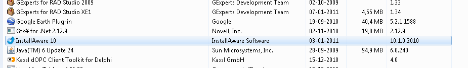

The working server is a 10.10 se attached screenshot. Installed on 3'rd of january 2011
Capture Working.PNG (16.1 KiB) Viewed 23030 times

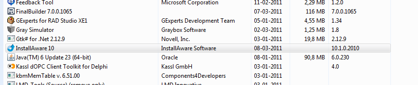

The not so working server is 10.10 installed today - with fresh generated license. Se attached screenshot.
Capture Not Working.PNG (25.4 KiB) Viewed 23030 times

The Machine still working (phew) :
- InstallAware_10_With_Runtimes.exe downloaded 03-01-2011, license generated and downloaded around that time.
The Machine not working (my primary build server)
- InstallAware_10_With_Runtimes.exe downloaded 08-03-2011, license generated and downloaded 08-03-2011
