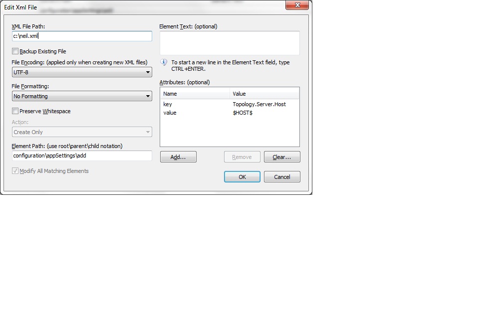

I just have one last question. Please see the attached screenshot. The Action drop down is disabled and is showing 'Create Only' so it will only add the new key/value pair and not update an existing one. I just realized that we did have a license for IA 11 so I registered the product. I have version 11.0.2.2011 on my machine. Am I missing something? According to the help I should just be able to change the action. Once I can do this it should work perfectly.
Thanks for all your help!
Neil
Neil
- EditXML.jpg (71.26 KiB) Viewed 11878 times
Re: Edit XML File
This shouldn't be the case - which edition of InstallAware do you have installed?
Re: Edit XML File
I have version: 11.0.2.2011 installed. Studio Admin edition. I'm using the GUI to access this features not MSI Code.
Re: Edit XML File
What happens when you double-click the Edit XML File commands in the MSIcode? Are you able to change the action in that dialog?
Re: Edit XML File
