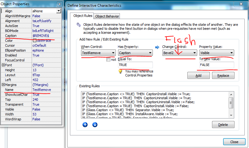

Make the flash control invisible if REMOVE=TRUE.
- ia.invisible.PNG (109.12 KiB) Viewed 13882 times
