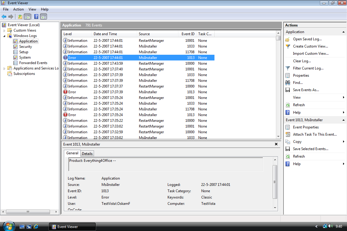

I built a setup that works just fine on Windows XP. On Vista it gives an error on the moment of the 'Apply Install' (Fatal error during installation)
Even when I modify the setup and actually remove everything from it still produces the error!
If I look in the eventlog I see an error 1013 in the MSIInstaller...
Anyone?

It is error 1013
Postby fosnl » Wed May 23, 2007 2:44 am
I'm sorry to say it is error 1013...
I stripped my whole setup and it is actually installing nothing anymore - and it still produces the error.

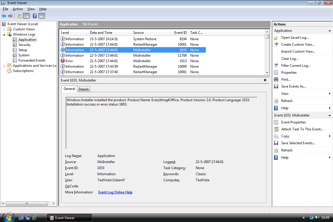

The error '1013' is the EventID... actual return code 1603
Postby fosnl » Wed May 23, 2007 3:51 am
The '1013' code is actually the eventid posted in the Eventlog...
If I look a few events later It shows that the Installation returned a '1603' code...

Postby fosnl » Wed Jun 27, 2007 2:53 pm
No idea, I had no response anymore from Installaware about this one.
Our project was built in version 5, then modified in 6.5 and later 6.6 when it gave the problem.
We just re-created a new project whith the same code and that one workes fine on Vista.
