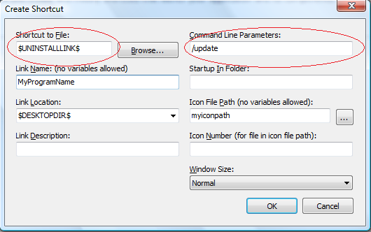

Now, in your main setup, instead of creating a shortcut for your application’s EXE file (ex: C:\Program Files\My Software\My Application.exe), create a shortcut for $UNINSTALLLINK$ instead (type this inside the Shortcut to File field), and specify the “/update” command line parameter for the shortcut, which will start setup.exe in web update client mode (instead of the regular maintenance/uninstallation mode).
Also, remember to change the shortcut icon to your application’s icon, so your users won’t be confused with a setup icon in their Start Menu.

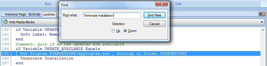

Search for the “Terminate Installation” command throughout the updates script. I recommend typing Ctrl+F and searching for “Terminate“, and then repeating the search by typing F3. That way you won’t miss anything.

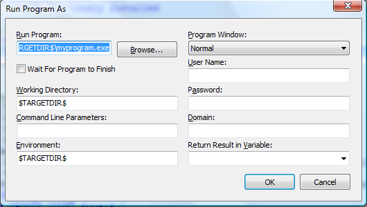

Before each “Terminate Installation” command, insert a “Run Program As” command with the target being your main application file (such as “$TARGETDIR$\my application.exe”), and also setting the working directory to “$TARGETDIR$“.
Copy-paste this command before each “Terminate Installation” command inside the updates script. With this simple trick, your application will launch any time the web update client exits – be it upon user abort, failure, or successful update installation. You’re fully covered since you addressed each script termination point.
