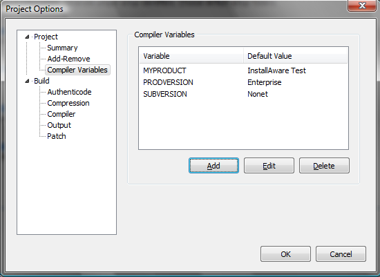

Compiler Variables are defined inside the Project Options window. To bring up this window, click the Project Settings button, found inside the Manage group of the Design tab.
Choose the Compiler Variables section and you’ll see three buttons, Add, Edit and Delete. This is where you define and set the initial values of your Compiler Variables. These variables are accessed using the #COMPILER_VARIABLE_NAME# format inside your MSIcode script. You may use these variables anywhere inside your script. Even MSIcode command fields which do not ordinarily accept variables will take compiler variables, since compiler variable values are “burnt-in” at build-time, and do not change at runtime.

As you can see, one of my compiler variables is “MYPRODUCT” and its defined/initialized on the Compiler Variables section of the Project Options window. The above code builds some files and features if the compiler variable “PRODVERSION” is equal to “Enterprise” but excludes one file if the compiler variable “SUBVERSION” is not equal to “Full”.
